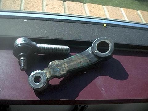

For steering, I used a set of All-Pro Hy-Steer steering arms, All-Pro tie rod and drag link, FJ80 tie rod ends, and a modifed pitman arm. The pitman arm had to be modified because the joint was built into the pitman arm, but the FJ80 tie rod end has the joint built into it. So to fix this, I had the joint in the pitman arm removed, took an end off my old steering linkage, sized it to fit into the pitman arm, and had it welded in place. This end already had the correct taper to fit the FJ80 end, so re-tapping was not neccesary.
