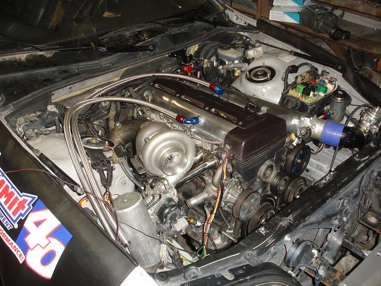

Turbo
    | engine |
Turbo:
74mm ITS turbo
XSPower Manifold
XSPower 3" intercooler
Tial 50mm BOV
Tial 38mm WG
Custom piping
Custom intake maniofold
Q45 Throttle body
Custom stainless 3 1/2" downipe
Custom stainless 4" from downpipe back

Intake Manifold
    | Intake |
The intake is a custom made intake using 4" aluminum piping, and 1/4" aluminum sheet metal.
Velocity stacks were manual spun out of 3" bar stock on a manual lathe, then flow tested
within 2cfm.  The stock NA manifold was cut short, and the aluminum plate was cut out with a hold
    | Intake with fuel rail |
saw to fit each runner, then welded.  Each velocity stack was then welded to the top of each runner.
Using several specified pieces of 1/4" aluminum sheet, the manifold was assembled and welded together
to form a nice tapered design to the thottle body plate.  A Q45 flange was used for the larger 90mm
Q45 throttle body.
