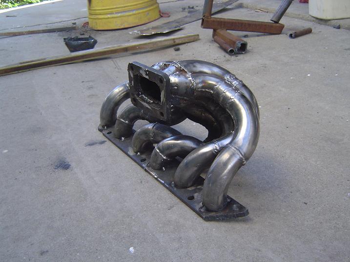

Custom tubular manifold

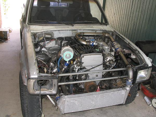

Picture of engine as of 9-18-04

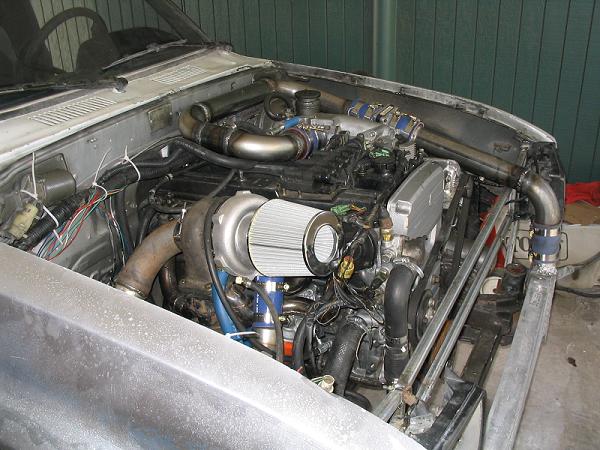

Unfortuanly I did not make it for Vegas. Upon staring the truck and tuning, I got about an hour into it and lost compression. I had to tear the motor back down to figure out what went wrong. It seems that the .040 over pistons I got were only .030. The machine shop bored the engine over to match the pistons so that was correct, but my rings were .040 over rings. Well as you can probably guess, there was not enough room for the rings to expand, so they burned up. By now, there was no way I could get it done in time for Vegas, and because of time, this project has now been put on hold until next spring. Here are a couple more pictures.
FinshedJust need to add the hood and grill.
Another finished picture

Well, 4 more days until I have to leave for Vegas. I still have a lot to do. I am still awaiting the turbo and transmission. Here are a couple more pics of what I have so far.
Engine bayHere is what the engine bay will someone look like. Just imagine the huge turbo in there

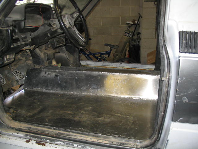

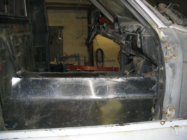

I have removed the interior of the cab, cut the fenders off, and have removed the floor. Doing this resulted in about 300lbs weight reduction.
I will replaced the floor with aluminum, and build a roll cage with lighter weight seats, and 5 point harnesses. Picture of floor
Another picture of floor
