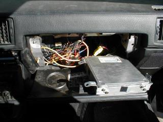

The C1 connector(yellow connector near ignigter)
The B1 connector(Large yellow connector near ECU)
The M1 connector(Small yellow connector near ECU)

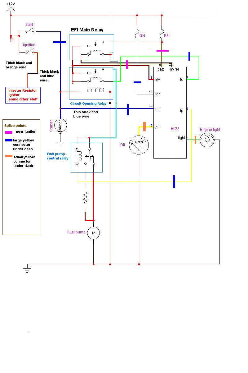

Wiring diagramThis is a large BMP file. I could not convert it as it would mess up the colors.
